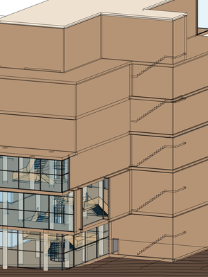

Extra lines on my 3d model protruding from the interior to exterior! Not sure what to do!!

I have been having this issue since last night, I had done the following so far: Updated my Graphics Card Driver, updated my laptop, closed and opened the revit file multiple times, checked the properties.. nothing seems to work!
The model seems to have some doubled lines along the walls and floors and its showing some elements like stairs through the exterior façade. I attached an image for you. Anything helpful will be appreciated. Thank u!

Do the lines appear if you zoom closer?

The lines appear whether I'm close or further away from the model... I'm worried its an issue because I redrew my floors so that they don't go all the way to the exterior of the wall. Any ideas?

The lines appear whether I'm close or further away from the model... I'm worried its an issue because I redrew my floors so that they don't go all the way to the exterior of the wall. It seems like sometimes when I do certain things or zoom in and zoom out, additional lines start showing as well. Not sure.  Any ideas?

Delete your 3D view and create another one.

Check your eye and target value. Larger value means your view will display as wireframe. To fix it use the viewcube and click on the isometric to reset the view back to normal.

Thank you! That worked.

That was exactly it. When I deleted the 3d view and created a new one, the numbers were adjusted to something smaller.
