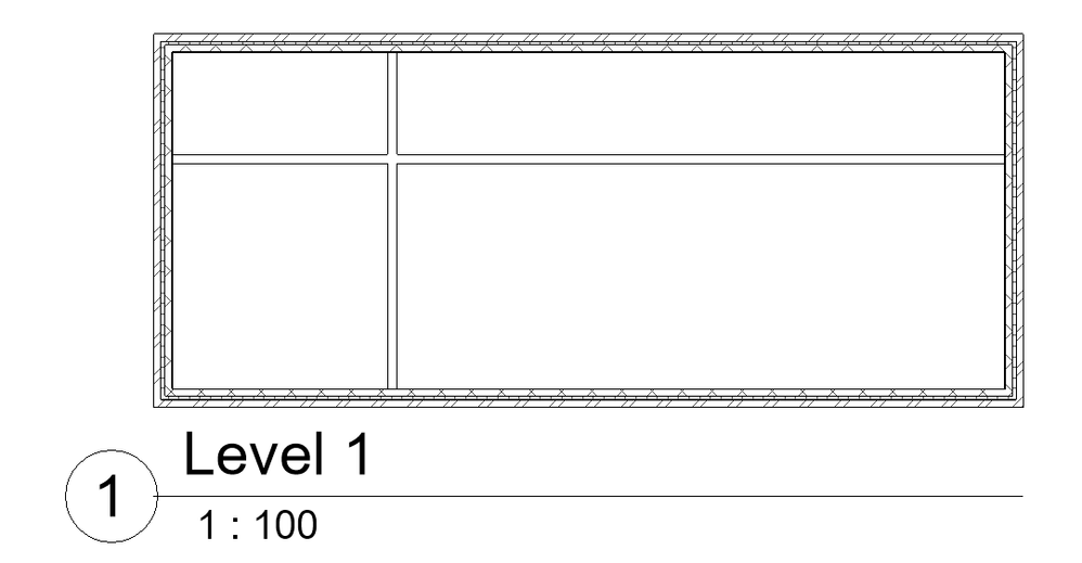

In the same view I need the exterior wall shown in Medium Detail and interior walls shown in Course Detail.
I put the walls on a separate workset. I thought I could use a filter. I couldn't control the detail level.
Any help would be appreciated

Like this?

You could create duplicate views, one with exterior and one showing interior and then overlay them on a sheet to get the effect. There are some issues you may encounter but it will be close.

alright, i give up... how'd you do that.... :leicht_lächelndes_Gesicht: LOL
Phase Filters......?

That is what I need!!
How did you  do it?

Thank You . I see how you did it.
However this project is already phased.
How can I do it with new construction walls?

I would do what @loboarch suggested. Place the medium view on sheet first and the coarse view 2nd.
On another thought, you could create parts from the exterior walls and set the view to show parts + coarse detail level.

Yes, phase filter.
