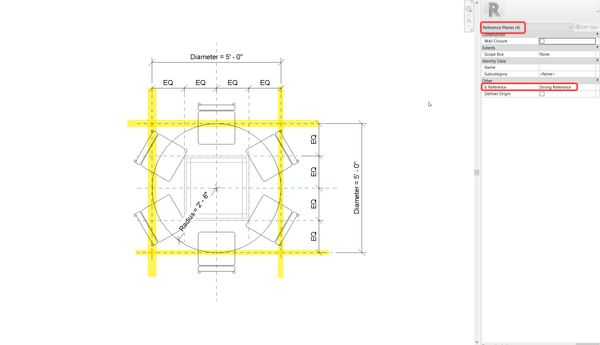

I have made this family attached, which is circular table with parameters. I have the arrows in the Revit model space but it wont let me extend. It disappears once you pull the arrows. What part of the formulas or parameters Ill have to correct to have the size of the table adjustable and have more chairs around?

thank you again, what I am trying to do the thing you showed by pulling the arrow I highlighted
Nachricht 9 von 12
als Antwort auf: BBV90
Make the Ref. Planes Strong Reference.
...and if you want the shape handles visible in 3D, then replace the Ref. Planes with Ref. Lines.

  Did exactly how you said and still not working, I even lost the arrows in 3D. Attaching family.
Nachricht 11 von 12
Nope. You didn't.
Don't use Reporting Parameters. They DO NOT drive anything. They only REPORT.
ALSO, there is nothing is constrained to the Ref. Lines.  The idea is that when the Ref. Line - or Ref. Plane - is moved, it pulls whatever is constrained (Aligned and Locked) to it along for the ride.
