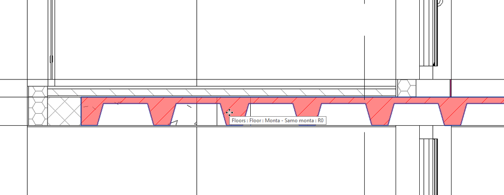

Hi everybody!
I'm starting to learn Revit on a simple house project.
I'm trying to extend the bottom insulation of the floor beyond the boundary of the floor structure, so it meets with the outer (vertical) insulation of the wall. Is it possible?  I attached an image of what I want to do, for better understanding.
Thank You!

Two solutions.
First is to just extend the wall insulation by how much you need it to meet the one under the slab, in this case 15cm. They're the same material and will clean up automatically.
To get what you want (insulation under the slab to go to the wall exterior line), you need to edit the floor footprint and get it all the way out.
 Then you'll end up with this mess:
To fix that you need to use the cut command and "cut" the wall from the floor.
The drawback of this approach is that you'll have to cut them manually on every single wall if you want accurate material takeoff. Works for really small projects, a nightmare for big ones.
That's why I simply create them as separate floors. Construction floor as one floor, finish layers another floor, gravel (or in your case insulation) under the slab, third floor...

samantha_vuk
als Antwort auf: samantha_vuk
That is actually the best idea so far. I lost a few hours on this.
Until a better solution arises, I'm going to stick with your double floor idea.
Hvala!
