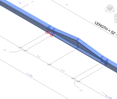

1|  I made this framing family, with the normal grips I can stretch the beam, but when I stretch with the grip handles it doesn't extend/stretch. I locked the ends of the beam to the left and right reference planes.
2|  Also, when my beam is shorter than what I initially drew, it gives the beam a weird dent.
I drew this beam with different sections and connected it with extrusion blend to connect the shapes. The angle of the top line should always remain the same: 5cm/m.
How can I fix the family?

Constraints are not set correctly in the family.  Share it here, or open an OOTB bean and reverse engineer how it is built.

Here: see "Family3.rfa" in the attached "Project MARV.rvt".
Nachricht 6 von 6
als Antwort auf: mv2JHHXL
Note these additional "bonus" grips as well:
Happy Reviteering.
...one more screenshot to aid you:
