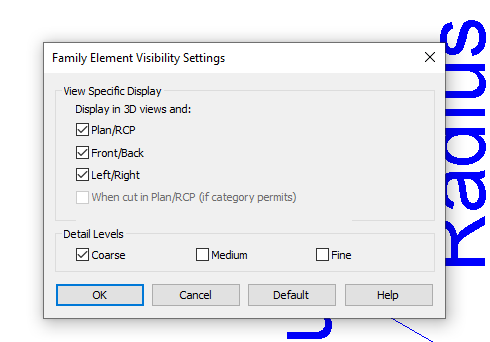

Hey.
could I somehow "force" export to IFC all elements as "fine" although they are defined in the family editor as "Coarse"?

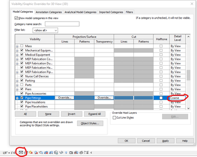

Create a Fine view, VGO the category to Coarse, and open it when export to IFC with these settings.

You would have to edit the family.

@ToanDN I tried it before and it didn't work.

@ToanDN
look at this...really weird behavior...
one PS is from IFV Viewer and the other from Revit.
maybe because you are using a generic model?
one more thing: on the visibility graphic when Im choosing "coarse" it looks like this and when I'm choosing "fine" i can see only the symbol.

@ToanDN
Thnaks, i needed to check "export only elements visible in view" .
very weird behavior.
