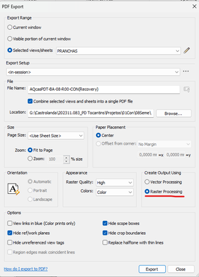

Hi.
From yesterday I have a problem exporting to PDF. First Revit began to show a warning before crash: Video driver error ocurred. I read many forums about the warning that recommend upgrading video controllers, but now when I try to export a PDF, Revit just stop working without warning and I have to close it from Task Manager.
Can help me?

try using raster option

I changed those parameters but it doesn't work. I solved the problem downgrading video drivers, it seems there was a compatibility problem with the lastest version of Intel Iris drivers and Revit. However, thank you for support.
