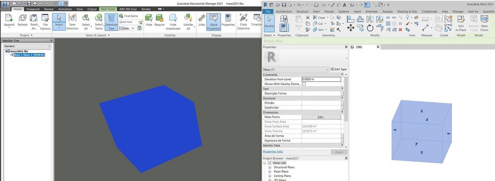

Hi all, I have a question regarding FBX files. How do Export an FBX to include massing?

Hi @mafasesodi
Is there any issue?
I can see it is working.

@mafasesodi
You must be in a 3D view and have the mass family visibility enabled. The visibility can be set either in the global override in the Site menu or in the views local visibility graphics settings.

als Antwort auf: lucdoucet_msdl
Thank you.
