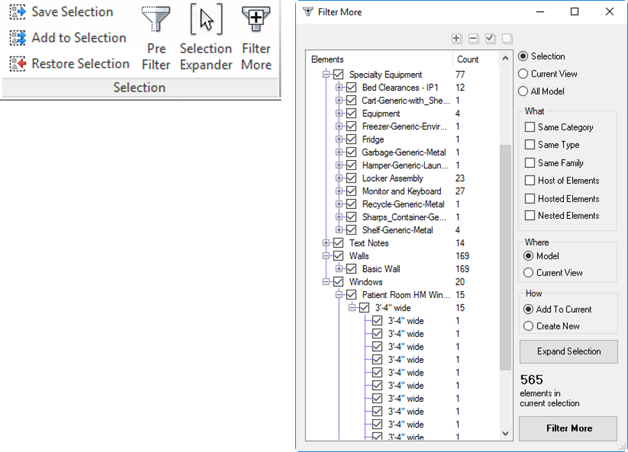

FilterMore | http://bit.ly/FilterMore
FilterMore is an advanced filter that will let you view your current selection as single elements and grouped by category, family and type. It will also let you expand your current selection through different options like nested, hosted or host of elements.
