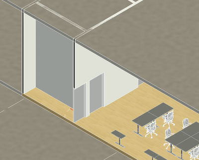

althea6DYP8
As you can see in the above, the material is fine when I use a section box and all in default 3d space.
However I have an error when I swap to camera mode:
Both are on realistic, I have no idea what is happening, and I have a review in a bit, please help!

althea6DYP8
So I figured what happened in the second screenshot: it was not set to parts.
Turns out that when enscape saves a view to Revit, it goes to default (Show: Both or Show: Original).
Would it be possible for devs if anyone sees this to work with Enscape to save views in full accordance to the settings set when the view was opened in Enscape? Eg: Opened in 3d View, Set to Show: Parts, Enscape will make a view with the same settings.
