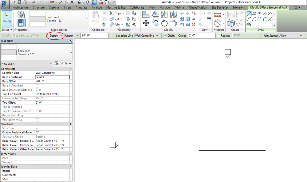

i have so many question. Why is it when create my walls, there is a warning that says None of the created elements are visible...i usually use to create walls but not encountering this. Thank you.

Did you happen to create Structure wall and have Depth selected in stead of Height?  If so, it is the reason the wall is not visible because it is drawn below the level.

Right! I must have unknowingly selected it. Noob. Thank you guys esp @ToanDN.

In addition to what @ToanDN shared, there are Wall: Architectural and Wall: Structural that you can choose from. If you selected Wall: Structural, by default, the setting is DEPTH.

Thank you for this information..this is what i have selected. Great to know this information @Richard.P.Garcia. Thank you!
