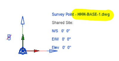

hliS658H
Do not be so absolute. These steps are not so complicated, remove link - reset shared coordinates -link survey - reposition - acquire coordinates.  It just happened - I didn't run into this issue with other projects which I started from scratch. I took over this one and an old survey with complete different name was linked until we got a brand new survey and even after the old file was not linked  in the model anymore , it still shows next to "Survey Point". I suspected that caused this problem but don't know how to get rid of it.
Message 15 of 18
As I already said, it is the name of the Site.  You can literally change it to Mars or Uranus if you want.  If you want to convince me then share the site model and the DWG here.

hliS658H
The link is there at the bottom;
I am just puzzled why survey point has the old survey file listed. At least I still have coordinates of survey dwg and revit model matching each other after disabling shared positioning. That is something I am concerned more.
