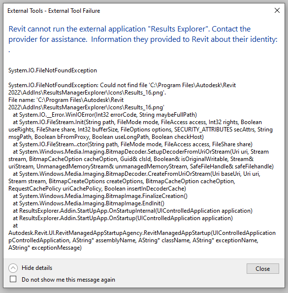

Since the update I get this message at start up.
error msg at start up (1)error msg at start up (1)error msg at start up (2)error msg at start up (2)

Looks like it's being thrown by an Add-in.  Disable Add-ins to verify.
How to disable add-ons for Revit | Revit | Autodesk Knowledge Network
