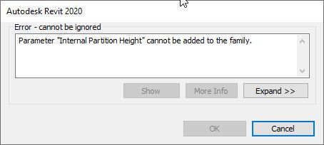

I am receiving the following very annoying message when creating an edit in place void which cuts a system wall.
Firstly I create a wall and I then assign a global Revit parameter to the Top Offset.
Secondly, I create a edit in place Void geometry which cuts the wall element.
When I finish editing the edit in place element, I receive the message below.
Weirdly, when I assign the parameter after creating the void I do not get any error message.
I trust, this is a Revit bug.
Would it be possible to share any ideas why what is causing this?
Many thanks in advance.

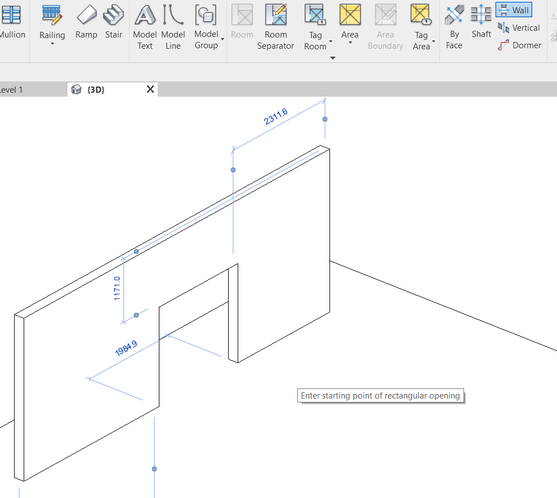

However if I use wall opening, it works.

Did someone mention "BUG"?  I love finding BUGS!  Bummer is, I seldom do -- including this time.  I can't seem to replicate what you two have discovered. Maybe my workflow is flawed.  Can one of you lead me through the steps to replicate the "BUG"?  Thanks in advance.

I could replicate it but it seems to be an issue in Revit 2020, works with Revit 2021 though...
Nachricht 6 von 7
als Antwort auf: martijn_pater
I confirm the above problem occurs in Revit 2020.
