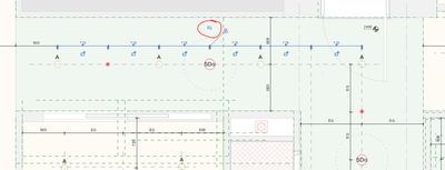

Hello All,
Could be possible receive some advise regarding dims? I cannot understand why sometimes when I am using EQ within dimension I only can see with numbers and not with EQ letters. Please see attached screenshot
King regards,

that is strange. try to create a new dimension? and try to install latest updates from autodesk and see if helps. thanks

It's happening sometimes, not always. I cannot find a path for this, everything is updated... I am becoming a bit crazy

have you try to tick audit your file before opening? thanks

try to click this icon see attached and see if helps. thanks

No sorry, that is not working.
In the first post I attached a screenshot where shows that property "Equality Text". If I change to "Value" and I come back to "Equality Text" is still the same problem
