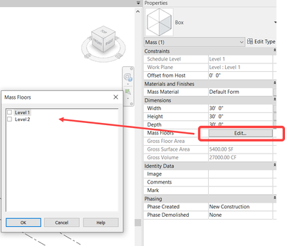

I have my fully created 3D model, Which has conceptual mass and the mass floor. Also I created the energy model of the mass, but when I run "Create Energy model" It keeps telling me
"There are no visible Masses in the current View.
Either create a mass or adjust the visibility of an existing Mass and try again."

Create Mass Floors.

huick2
als Antwort auf: barthbradley
Yes, I already created the mass floor (see the attached image), but still can't run the energy analysis

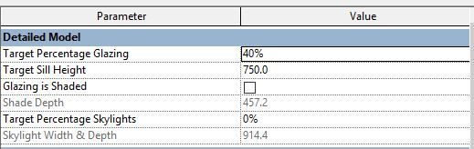

huick2
als Antwort auf: ToanDN
I just want to sim the mass instead of the building elements.
Because building elements cannot apply the detail model parameter in energy setting dialog box.

Nachricht 12 von 19
huick2
So means revit cannot run the report by itself? Must be generate the report by insight?
Nachricht 13 von 19
huick2
Nachricht 14 von 19

Nachricht 18 von 19
als Antwort auf: huick2
Use Conceptual Masses: This mode is used with legacy workflows. This mode is provided only to support older models. Some advanced energy settings relate only to these legacy modes; those settings are unavailable when the mode is set to Use Conceptual Masses and Building Elements. See Create the Energy Model: Massing.
Help | Energy Settings | Autodesk
Nachricht 19 von 19
huick2
Many thanks for the explanation.
Is it possible to change the Revit 2020 to legacy mode?
