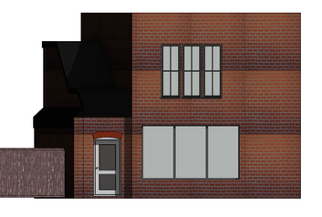

hello if its not a phase issue and its not a hidden object issue, what are the other possible causes for an elevation not displaying correct? Below shows how it looks in elevation and in the 3D view, i am missing a whole section of roof

In plan view, click on the tip of the elevation symbol. Adjust either the width of the blue plane or the depth of the view.
In elevation view, turn on the crop region and see if its size needs to be adjusted, too.

thank you!!!
