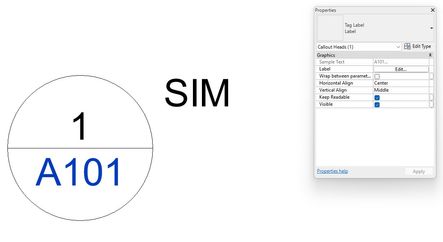

You need to set the label for the sheet callout in the elevation marker to Center/Middle and Fixed Rotation.
Nachricht 10 von 15
jill_m_hanby
als Antwort auf: Mike.FORM
Thank you for replying. I am using Revit LT 2023 and there is no Keep Rotate button! Screenshot 2023-05-30 173903.jpg
Nachricht 11 von 15
Mike.FORM
als Antwort auf: LyndsB

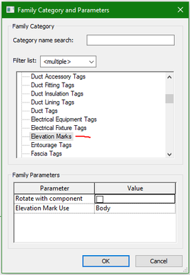

Is that a callout marker or your elevation marker?
This is my callout marker. They do not have the keep rotation option.
Make sure the family category is set to Elevation Marks.
Nachricht 12 von 15
jill_m_hanby
Thank you for your help! I finally got it!

Also, how does your elevation callout work when you have more than 1 view from the same marker.
Elevation marks are made from a body with a nested pointer.
The pointer should contain the drawing/detail number and the body should contain the sheet number.
Everything in the pointer rotates while everything in the body remains stationary.
