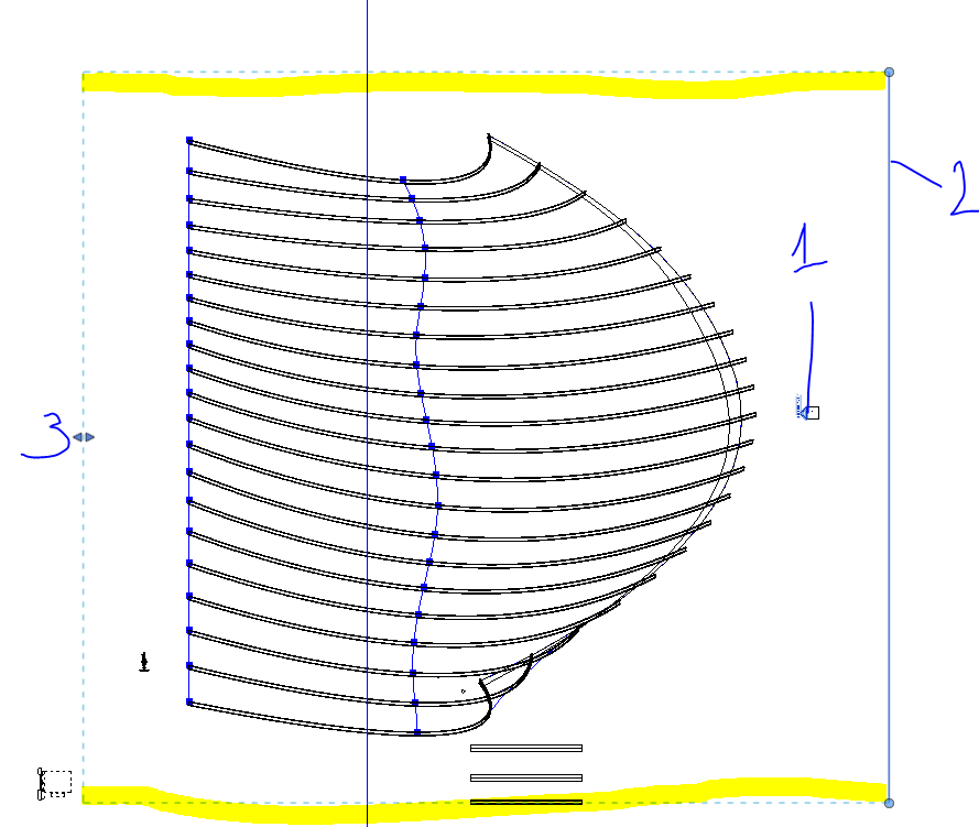

Hello i am creating some elevation views from a 3D model problem is they look more like section views(see below). I know you can adjust height and depth of the elevation but i just want to detail internal items. I have been getting round this in other views by adjusting the cropping box but this seems abit clunky, what am i doing wrong?

Hi @Anonymous,
You have to know that elevations are just like sections.
As a proof, view templates can apply to both.
The big difference lies i nthe way to place them.
Elevations will automatically orientate itself perpendicularily to walls, and its symbol on a sheet will be different.
For sure the cutting line of your elevation goes through your building and the bathroom...

On a floor plan, select your elevation symbol, a line will appear which shows
- where you are creating your elevation view
- how far you are looking (if far clipping is off)
So if your view line is placed through your plan: it still cuts your project. I guess that is happening to you right now.
So select the line on your plan view, drag it away from your building. and all should be good.

Here is a picture to make it clear:
  1. is the elevation mark. Click on the arrow to make the elevation cutting linea appear
  2. is the elevation cutting line. As it works exactly like a section, it represents the section line.
  3. is the view depth. the handle allows you to set is as required.
In your case, just make sure that the section line lies well before your building!

Yes i know elevations and sections are similar but i always think of sections as a cutting view and elevations as non cutting. Because i have an odd shape room i dont want to see the loft space above the ceiling i cant get rid of it using the crop tool as this only deals in squares or rectangles...
Nachricht 6 von 6
als Antwort auf: Anonymous
For odd conditions you can use masking region to mask out area you don't want to show in the elevation.
