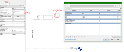

Hey all,
I'm just trying to find a way to access "Elevation From Level" and use it as part of a formula. Essentially I want to set the height of the "Fly Killer" family via the EFL, which then drives a forumla in the nested socket making it appear at the correct height.
Has anyone found a way to make this work?

Yes. In fairness I'm probably not explaining myself very well either. Let me give it another shot.
At the top tier of nested families I've got my "Combined Fly Killer" family loaded into the scene. This is where I need to be able to set my Elevation by Level.
Inside that family I have the fly killer itself modeled, a separate loaded in family which is just a plug socket, and a variable called "Electrical Connection Height".
What I want is for when my Fly Killer is at "EbL" or 1800, and my "ECH" is set to 2000, I want to do "ECH-EbL", and offset my plug socket off the reference plane by 200, meaning that in the main project it will be displayed both at the correct EbL but the socket is also moved correctly.
The heights in my project are not always set the same so I can't have a bunch of preset heights in there ready to go. Ideally I don't want to be setting this twice, once in the "EbL" and with a second variable as I know they will eventually be different from each other when someone forgets to change them both.
Having access to "EbL" really would have been ideal but I don't think it is possible anymore like this.

Message 16 of 17
Mike.FORM
Alright, here is the more complicated version. The fly killer family is workplane based and hosted to the reference plane controlled by EBL. EBL and ECH is pushed to the nested family which has a parameter called "offset" which uses the formula ECH - EBL.
