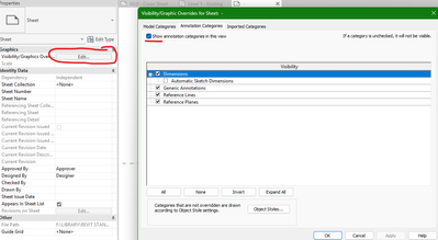

Hello group, I´m wondering on how to "control" the size of the lines of the elevation Annotation
I change the size of the symbol, but there´re lines that where not visible in the symbol falmily, and when I load it there are lines that are the size of the previous symbol.
Thanks in advance

If you are talking about the leader line weight, you can change that in the type properties of the spot elevation.
morris_duncan
Nope, I´m Talking about the line that I marked with orange in the upper image
Mike.FORM
Look in object styles in the project under spot elevations.
If it is a subcategory in spot elevations, once its loaded into the project, making changes to that subcategory in the family does not update it in the project. You need to update it in the project.
morris_duncan
The Issue is not about line weigth, but about the size, I "rescaled" the annotation symbol, but when I loaded the family into my  project those lines appeared and I don´t know how to resize that.
Mike.FORM
edit the family, select the "-" sheet in the family, check the vg settings, and make sure annotations are turned on so you see that line in the family.
morris_duncan
Sir, you are a genius !!!!
So many thanks
