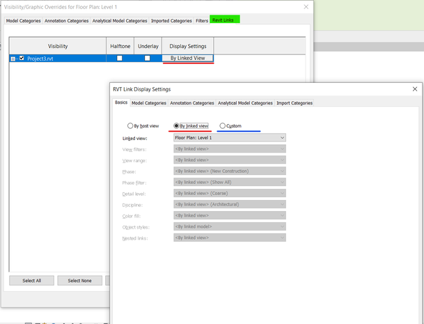

@gonzalezrR7T6N
If the Linked structural model is not responding to view rang change in the host model, check the RVT Link Display settings. It might be that it is set to display as per Link or Custom

gonzalezrR7T6N
@RDAOU
View Display Settings were set to Custom, but still having the same result.
Royy
Message 7 of 9
RDAOU
@gonzalezrR7T6N
Custom implies that the view range of the link is most probably not the same as the host....
- Either open the link and adjust the View range therein and reload
- OR keep RVT Link settings custom and select a view where the view rang is suitable and those elements do not show
- OR set the RVT Link Settings to Host then the View rang of the link will function as per that of the Host
