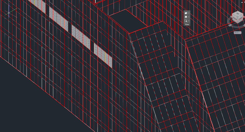

I have a big problem in Revit when  I am exporting DWG elevations.
My building skin is made with a external facade done as a curtains system attached to a mass, all the facade is curved.
When I open the exported  DWG a big percentage of the curtain panels are located in the wrong position and the same is hapening with the mullions...
I dont know how to solve this....its a big building and takes me hours to replace the panels in the DWG.
When I print gives no problems, when I export a straight curtain wall gives also no problems.....help!!!

You model is way too far from the Project Base Point, which in turn, is very far from the Survey Point.  I link it to a new file, move it near to the Project Base Point, and exported it just fine.

I created two new elevations and placed them on a sheet in the new file where I linked your file in.  The sheet exported without any problems.
See screenshots for comparison from Revit to CAD.  CAD file attached.
p/s:  I could not work on your original file.  It froze my old and laggy 5 year-old laptop.

I tried the same as you now and it worked :leicht_lächelndes_Gesicht: but I cannot have a extra file just for the elevations :enttäuschtes_Gesicht: .
The project base point is also a issue. When I move the point to 0,0,0 I lose all the coordinates points from the project and that is something that i cannot lose..... :enttäuschtes_Gesicht:
I dont know what else to do.......
Is there any way of keeping the project base point close to model and preserve my coordinates with the model???

I did that immediately and is still doing the same.......I´m so frustrated. Maybe there is an error on the file.
What I discovered is that on the export file,the panels not only are dislocated in X but also in Z and that makes it easy to put them back in place....is not a solution but reduces my time in fixing the DWG file in several hours :).

You don't have to redo the elevations. After create the elevation in the new file, VG, link tab, change the link to custom instead of by host, and find the matching elevation view from the list. It will make the view look the same as the original elevation view with all the annotations intact.
