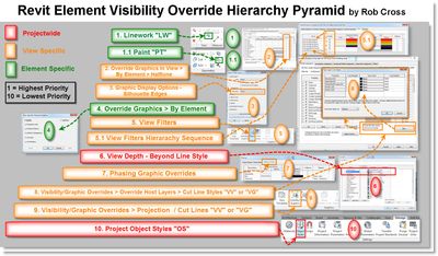

als Antwort auf: cbt990
overrides have Hierarchy's. like @barthbradley said, check for other overrides.  here's something to help....
