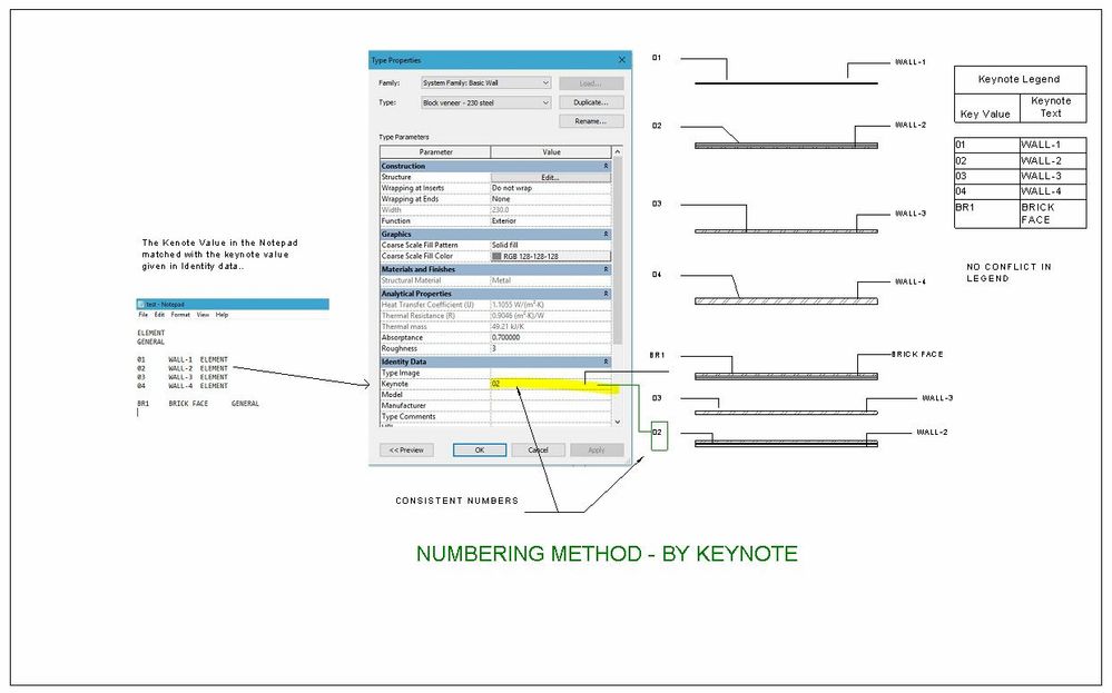

Hi
There are two options to get keynote correct.
This is what I Found..
1. If you want to use keynote numbering using Sheet, then Use only " Keynote TEXT " and don't use
keynote Value ( because legend is going to use as per Sheet... ) creates a conflict between value in tag, and value in legend. because Tag is trying to read from notepad and legend is trying to read value from family type parameter.
2. If you want to use "Keynote Value" and use those numbering/ values in the Legend as well, then you
need consistency in a. Keynote Value in Family, b. Keynote Value in Notepad..
( in this case using legend by sheet will conflict everything )
have a look at this and see if that helps.. explaining above two conditions..
