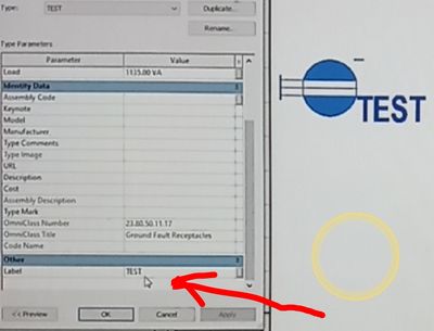

yes_and_no
als Antwort auf: barthbradley
This is outlet with label HVAC
Edit type, duplicate, give new label text "test"., voila.
I wd like the same convenience to room tag label. Besides room area, finish, etc. I can instantly add new type with label that read "no BIM work", for example.
