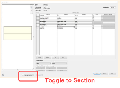

Can you show the entire window of the wall assembly dialog?
Nachricht 3 von 15
dgencheva
als Antwort auf: ToanDN
See below:
Nachricht 4 von 15
als Antwort auf: dgencheva
Are you wanting Section Preview?
Nachricht 5 von 15
dgencheva
als Antwort auf: barthbradley
The section preview shows all layers separated, I was wondering why they aren't showing like that in plan, too.
Nachricht 6 von 15
Probably because the View is Coarse Detail Level.
Nachricht 7 von 15
dgencheva
That's what I originally thought too, but I didn't see this setting available within the Edit Assembly dialogue. Have you got an idea where could I find it?
Nachricht 8 von 15
dgencheva
This is within the view itself, I was wondering about the Edit Wall Assembly dialogue. The layers are visible in the actual view itself.

Nachricht 13 von 15
Let's see what it looks like on my end. Post the file.
Nachricht 14 von 15
Change Sample Height to 3000. Then close and re-open preview panel.
