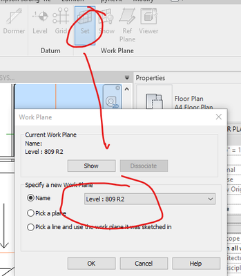

After I successfully made a railing with sketch for a run, I kept getting the error messages  when I tried to create another railing by sketch in plan, no matter it is multistory or single story stair, it seems to only allow me to do it in 3D view, but it is hard to sketch there.
Set the work plane of the view back to the Level.

Setting the work plane works for 2 -run stair.
I have a stair with 3 runs from level 1 to level 2, I have tried set either level 2  or  second landing as work plane, it allows me to sketch in both situations, but the railing always falls to the 1st run. which I can create using level 1 as work plane.
Nachricht 6 von 6
als Antwort auf: hliS658H
Before you sketch the railing, use Pick new Host and use TAB to select the specific stair run to host the railing.
FYI: Work plane is to show the sketch lines when you draw, it does not dictate where the host is.
