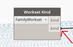

When I use Dynamo Player, the node duplicates the output part of the node causing the node to fail.
It works fine with Dynamo open. Just doesnt work with Dynamo player. Same goes to some other nodes I've noticed.
Is there something I am doing wrong?

That kind of thing used to appear when opening nodes which had been made for Dynamo version 1 in Dynamo version 2...
Dynamo 2 was a major upgrade and package authors had to re-code their nodes.  You find the node is normal when you you place it, but the next time you open the graph it has a 2nd output.... The next time a 3rd etc.
Maybe see if there is a more recent version of the package you can use?  If not, perhaps contact the package author or look for an alternative node.
