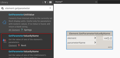

I'm going through some online tutorials to change information in curtain panels all at once instead of selecting them manually. I came across the node "Element.GetParameterValueByName" but I don't seem to find it under that name, since I'm new to Dynamo I was wondering if now it's under another name.
I'm using Revit 2023 with Dynamo version 2.13.1.5510

I think it is still under the same name. The search function requires you to fill in the name exactly.

Thank you so much, I spent a lot of time yesterday looking for it and couldn't find it. But I get now, I can't believe it was that simple :Gesicht_mit_Freudentränen:
