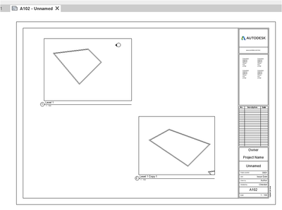

HELLO EVERYONE
Is there any way to export multiple sheets from revit into ONE dwg file (in autocad layout)? not in separate dwg files.
thanks in advance!

Or, instead of "Check All", just check the ones you want to Export.
khalili_masoomeh
thank you. By this method we will get some separate dwg files. but I want to for example choose some sheets to export and get 1 dwg files that contains sheets i choose. Is it possible in revit ?
edwin.prakoso
Unfortunately, I don't think you can do that.

 Try to unmark this box.
