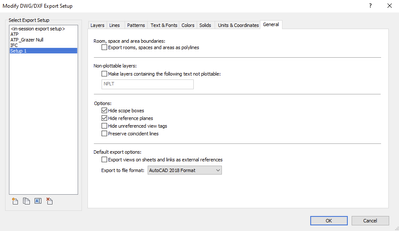

I have an issue that when I export my views to DWG there is no hatch exported in some views. It's always the same views, so it happens in G00 for instance all the time. G01 and other floor plans work fine, just G00 is struggling. Also in Elevations and Sections. Some are fine and some are exported without hatches. And in those cases it's not exporting projection surfaces as well as cut patterns, no matter which pattern (solid or crosshatch etc.).
There is a linked file (existing building) shown in all views, but I guess this is not causing this problem.
And I am using for exports always the same export setup.
Do you have any idea how to solve that?
We are starting to face problems with other project participants.
Thx, D.

Nachricht 4 von 4
dominik_zach
als Antwort auf: dominik_zach
I found the mistake after trying every checkbox in the Export Setup.
Actually it seems there is a problem with "Export Rooms, spaces and areas as polylines" so that hatches are not beeing exportet.
If you uncheck this checkbox the export should work properly again.
