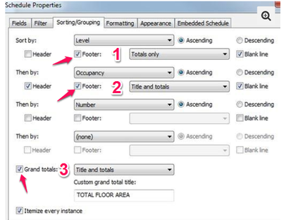

I have an Occupancy Schedule that is calculating total capacity for different occupancy classifications, and for providing a grand total for the floor. Just above my Grand Total, I get a duplicate grand total that is not labeled (see red arrows below). I’ve also included a snapshot of my sorting and grouping settings. Is the duplicate line normal, or is there a way to remove?

I think I figured this one out. My example is from a filtered schedule and it looks like the duplicate line is the grand total from the master sheet being filtered. I imagine it can’t be removed.

Have a look at your schedule. You create three totals If you want less totals you could remove one of them

@L.Maas is correct.  More specifically, the total you pointed the arrow to is the Level total.  I wanna bet that this schedule is filtered to show only one level.

It is you level total that shows up.
For more clarity in your schedule, add a blank line or display more than "total only"!
