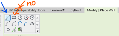

If you still want to draw walls that way, then use Line tool, not Box tool to draw.
