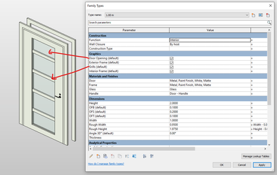

What I want is, When I enable Door Opening visibility then Grills Parameter will enabled with check or uncheck option. And If I turn off Door opening Visibility then Grills Parameter should be greyed out.

Not possible unfortunately. You can control it with a formula so that when x happens, y happens. But you can't make it so when x happens, you have a choice between y and z.
It would certainly be a nice feature. Parameters need an overhaul.
You can get close to your desired result by adding a third parameter. You have your opening opening parameter and a grills parameter. The opening parameter controls the opening viability like you want, but the grills one doesn't directly control anything. You then have a third parameter that is driven by the formula shown below. This parameter actually drives the grill visibility. When opening is unchecked, this is always unchecked. When opening is checked, it reads the grills parameter.
This doesn't gray out the Grills parameter like you want, which is unfortunate because that's the type of thing that can cause confusion for less proficient Revit users. But it will give the desired results that you want.

Did you associate the CTRL parameter with the visibility of the grills?
And you can name them whatever you want. I just like to use the prefix "CTRL" for parameters that are driven by formulas.
