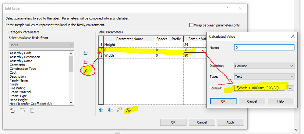

Is there a way i can change the way a door tag shows the Height & Width?
Below is what i have and what i am trying to achieve.
Tag displays 2400x900 is it possible to have this tag show as 24.090?

Only issue is when I go to over 1m wide it then displays at 24.0120 for 1200 wide. maybe i need to change the tag so it displays
24.082 for 820
24.120 for 1200
tried changing the increments however then i get the 0. not sure how to remove the zero from infront of the decimal place?

What would a tag for a 2400 x 1200 door be like? 24.120? If so, the above doesn't work for such.
Edit:  ha ha we must have written them nearly the same time.  Let me think about door over 1 meter.

Im using Revit 2013, I might not have the option to create a formula for a door tag?Capture.JPG
Nachricht 9 von 13
als Antwort auf: Anonymous
SOL.
You need to add a shared parameter to the door families and enter the formula for that parameter the same as I show above. Then add that same shared parameter to the label in the door tag family between the Width and Height.
Below is an example showing that method in Revit 2016 (2013 is the same).;

just having a bit of trouble creating the parameter
Nachricht 11 von 13
What sort of trouble?
Nachricht 12 von 13
als Antwort auf: ToanDN
just having a bit of trouble creating the parameter with the formula
Nachricht 13 von 13
So iv made the Shared Parameter, however its text? i'm not sure how i change that into a formulaCapture.JPG parameter.
