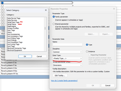

Thank your for this - it's very helpful. For my own learning would there be a way of linking visibility to a detail item /symbol  to switch on/off in a similar fashion or does this only extend to labels?
Nachricht 15 von 15
azad.Nanva
als Antwort auf: dharringtonJ5FG4
if I understand well, for this items i try to use the Family Type and Detail Items or Detail Items Tag category.
