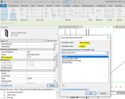

Door family materials and finishes parameter asking for length
I am attempting to add door material to my door schedule and for some reason it is asking for a formula as the parameter has been setup to length. Is their a solution to this?
It was created incorrectly as a Length instead of a Material parameter. Delete the parameter and recreate it, make sure to select the correct parameter type.
