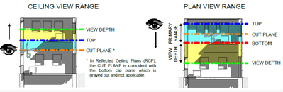

Weird... a door family missing part of frame in ceiling plan . And it only happened @ door height =7'-6". When door height = 7'0 , 7'2, the issue is gone... why cant be 7'6?

Ceiling Plan View Range is different from Plan View Range.  Perhaps this illustration will help you understand what is happening:
