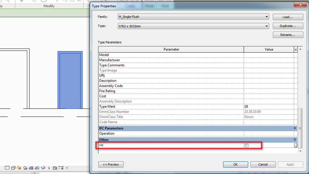

you can avoid such a situation if you introduce a Visibility parameter (boolean) for the Symbolic Lines in Door Family.
Constantin Stroescu
