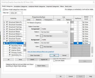

Hello. I am working in a Revit project with underground utilities, and I would like to know if any one knows how to see in a section box under de toposurface. I mean to not appear this cutplane on the left and looks something similar to the right.

VG and turn off Topography Cut Pattern.

Hello. I tried what you both said but nothing change. I mean When I cut the toposurface with the section box I would like to hide the cut pattern, and just leave thin layer of toposurface. I Change cut pattern on V/G to no visible, and change elevation of poche base to a elevation higher than my highest point, but is not working. Any other ideas.

Adjust your section box so that it doesn't cut the topo.
Nachricht 8 von 8
als Antwort auf: Anonymous
Split the topo near you want to cut then hide in view the part outside of the section box.
