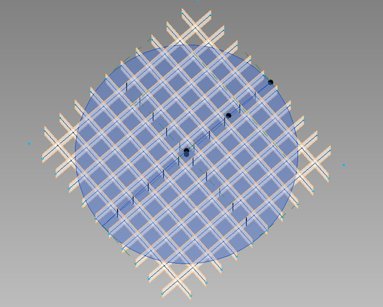

Can any one help me to make dome like such in skp screenshot for revit. I want to make in in Revit 2019 but when i create mass and divide its surface -then  i cannot change its U griid and V grid division as per the AutoCAD screenshot i mentioned (I want to change its profile). also how can i add my custom beam in the mullions. I want to add metal hollow beams and Rings to the end. I really appreciate if someone have its solution for this.this an example onlythis an example onlyThis is my real projectThis is my real projectTOP VIEW actual dimensions for dome gridsactual dimensions for dome grids

Open the OOTB Mass Dome Family (it fully parametric!) and Divide the Surface.

Yes this one I know but look at my dome top floor plan it’s different. The one you told me it’s getting at end centre.. I need in different way. Just try to understand if you can from my screenshot  of SketchUp also. I really appreciate your reply. :lächelndes_Gesicht_mit_lächelnden_Augen:

Like I said, it's fully parametric. But, you're going to need to create two 180 degrees revolve to be able to divide surfaces.  Can't divide your 360 dome.

For massing, I would create revolve arc to create a dome. Then you would create straight line extrusion to get the grid profile.
You may create another massing with the same shape and void as inverse so you get the mullion profile.
Load both massing into the project. Then you would use model by face using roof. Then create roof call glazing and apply glazing material. Once you apply the roof thickness, you will end up with the look like the screenshot below.

Do you have video for this ?
Nachricht 7 von 8
P93mahapatra
als Antwort auf: syman2000
I really appreciate if you the video link.it will help a lot,
Nachricht 8 von 8
syman2000
als Antwort auf: P93mahapatra
Here you go
https://youtu.be/BLFQ7RAwTdA
