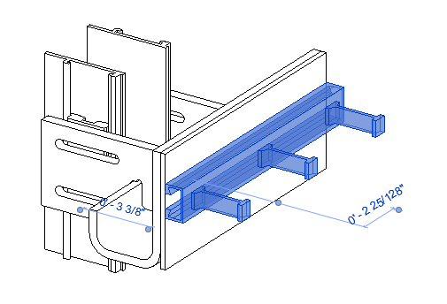

I have a family that consists of an anchor and an embed (selected below).  In one set of plans, I want all the components shown.  In another set of plans, I only want the selected component to show.  A visibility parameter won't work because it hides the components in all views.  Any suggestions on how to get them embed component of a family to be the only component of the family to appear in certain plan views?

@L.Maas, he want the nested object to be visible or not in some views.
What's your thoughts about changing only detail level? Like shows in Fine, but not on Coarse and Medium.

I've thought of that solution as well, but I'm not always the final user for the model.  When it goes to the customer or beyond, they may not know it is set up.  When my elements get coordinated with others, I don't want the embeds or anchors to fail to appear based on the current users' settings.

Would creating a new subcategory for the embed and/or the rest of the anchor be a possibility?  You could then control visibility with view-specific overrides on the subcategory(ies).
