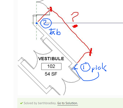

Dimension to corner of angled walls
Is it possible to dimension to the inside corner of angled walls like shown below without having to add reference lines? I cannot seem to snap to either endpoints or intersections.
12 ANTWORTEN 12
Nachricht 2 von 13
als Antwort auf: PhilvK
You can do it, but it takes finesse.  If you press the tab at the that inside corner, it'll cycle to a very small green dot. That's the point to select.  Begin dimension from the corner return and find the inside corner point last.
If Revit refuses to cooperate, then lay down a Ref. Plane at that inside corner and dimension from the corner return to that Ref. Plane.
Nachricht 3 von 13
PhilvK
als Antwort auf: barthbradley
Thank you! I thought that was the answer but have not had any success
tabbing to the green dot.
Nachricht 4 von 13
PhilvK
Got it! Thanks!!

Nachricht 8 von 13
rmc9WR3X
als Antwort auf: rmc9WR3X
I got it. You cut the corner of the wall with a longer corner than you want. To dimension it you grab the tiny green dots on the outside cut. Once the angled dimension is in place you grab its handles and drag them to the inside cut's tiny green dots. Now you can resize the cut of the wall however you need it (if you try to go too small the outside corner won't automatically change to a right angle, so you'll have to play with wall thickness or some other trick).

Nachricht 10 von 13
Sequence of picking.

Nachricht 12 von 13
@rmc9WR3X wrote:
The tricky part is dealing with an interior wall angle.
Not necessary.  Just use TAB generously at those corners until you see a blue dot.
