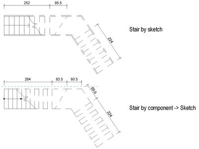

Why I´m not able to dimension Stair by Sketch?

I've recreated your stair and can't seem to properly dimension as well.
However, creating the stair case with Stair by Component and then using the sketch tool does give me more ways to dimension the staircase. It also allows you to place tread numbers. In general I try to avoid "Stair by Sketch".
