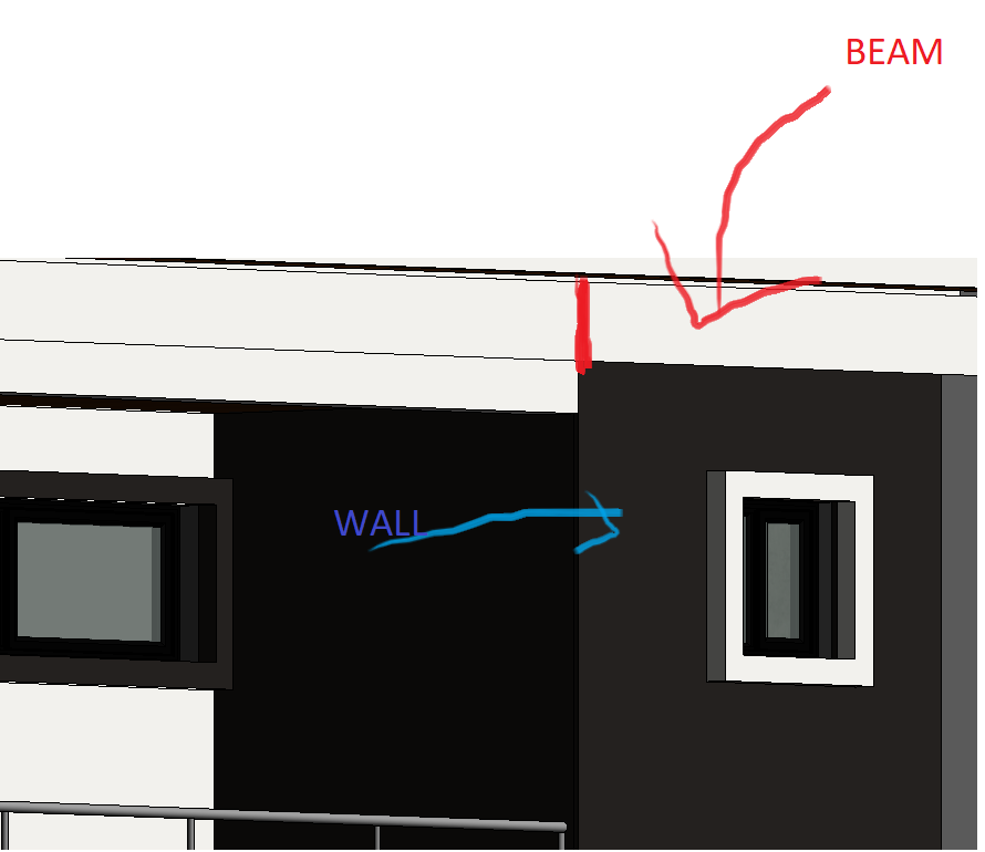

That's good then. So this is the issue, I want the beam to be the same color as the wall but only until the red line. One solution I could think of is modeling a component then joining.A.png
Nachricht 8 von 19
als Antwort auf: Anonymous
The way I see the construction is that the finish layers of the walls extend upwards to cover the beams -- in which case, you'd unlock the wall finish layers at the top, and then enter a top extension distance equal to the height of the beams. That make sense to you?

Hmm. Kind of. I kind of posted the wrong image. Kindly see the new one. The generic model is a "drop wall" I made to terminate the ceiling because the beam has a small depth.A.png
Nachricht 10 von 19
als Antwort auf: barthbradley
So I extend the wall layer up to the beam then join them? Just so you know I used parts tool on this wall and changed the layer material.
Nachricht 11 von 19
Look it; the point is that you are fastening your finish layers to the structural framing -- in the field AND in Revit.  If your "Structural" Walls are defined in Revit with Finish Layers, then use the approach I mentioned above extend the Finished Layers of the Wall to cover the Beams.  If the Finish Layers are modeled as separate walls over Structural Walls, then set the Finish Walls' height tall enough to cover the Beams.  If you want to create the Finish Layer as a "band joist"-type wall -- that works too.

Wow thank you very much, extending the layers worked!
