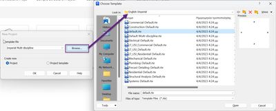

Did Revit get rid of architectural imperial templates in Revit 2024?

Revit 2024 now has reworked File templates: Imperial and Metric Multi-discipline. So it's all in one.

You always have access to previous templates by pressing the Browse... button.
