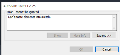

Likewise, if I open a 3D family template> create extrusion> try to copy paste random 2d linework from a drafting view into the sketch, I get this.....
So, for the most part, it seems like I can't copy any 2d linework directly from revit that I would like to use and if I can't copy 2d linework into a 3D family then seems like I still would need to go through autocad.
As mentioned before (I retested), I can take a drafting view> export it to cad> then drag/ drop it into any of the family types (2d or 3d)..... at least that's what I'm experiencing at the moment. I can also drag and drop it into a sketch (say extrusion profile sketch) within a family template, and that works as well.
Would like to get to the bottom of this. Is this really the solution to moving 2d linework in a revit project into a revit family to use the linework for creating extrusions and such or am I still missing something?

RLY_15
The copy + paste I was referring to unfortunately was specific to model/symbol line elements, not extrusion curves. So 2D to symbolic/2D, not 2D to geometry definition.
You should be able to use 2D lines as the 'pick line' selection for 3D definitions, but this will mean a bunch of clicks.
