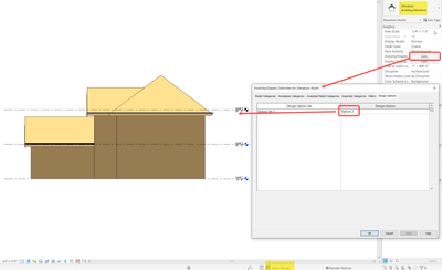

Hello everyone
How to use design options for the elevations
I want to do like this :zeigefinger_nach_unten: In one file

I don't understand. Design Options are for Model Elements. If your View of the Model is Dedicated to a particular Option, then that's all the View shows - in addition to Main Model Elements of course.
More about Dedicated Views:
https://help.autodesk.com/view/RVT/2023/ENU/?guid=GUID-9B06C4EE-D19C-4F15-8EA9-6A6208AAE6AC

I want to show the different elevations options only  on sheet
Nachricht 4 von 10
als Antwort auf: nadeemuddin
DEDICATED VIEWS.
See Link posted above.

sorry Iam new to this software
If iam modelling  roof in second option says option B
main model roof and walls are visible  in halftone
How to hide that greyout part

Again - YOU NEED TO DEDICATE THE VIEW.
You are in Editing Mode if you are seeing things grayed out.
Please read the Link I provided.
