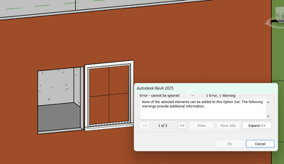

Is it possible to create design options for windows that are already hosted in a wall?
I understand that the normal workflow is to put a wall into all options in the Options set before creating different windows in the different options.  However, what if I already have windows and walls that already have a decent amount of work put into them. I don't necessarily want to redo all my split elements because I cut the windows out, then put the wall into the various options.
If I don't cut out the windows before trying to make my design option set, then I end up getting this error message:

Can you assign the wall to various options AFTER split element?
Are the door/window opening dimensions changed among different options?

Everything changes from option to option:  different dimensions, different split lines.
I would prefer to be able to make an option without messing up the dimensions and split elements in the original so that I don't disturb the working set of construction documents.  It seems like that is only a fantasy in Revit though.

This is the closest thing approximating a solution.  However, using your solution, the wall opening must be the same size between all options.  It is not possible to add a Straight Wall Opening to a design option.  It produces the original error.  So, in the end, your solution, while it does work, is very limiting because all window options must have the same rough opening.
The good news is, through all this trouble shooting, we have identified the Wall Opening as the culprit behind the broken functionality.  Hopefully Autodesk takes note of this conversation and fixes it 😂
